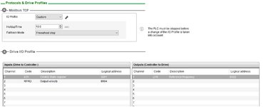

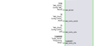

So, You missed to give information of You MB_Client-data.
But for a try I would do this:
Somove:
Remove CMD and LFRD from the command output list, move LFR to position(channel) 1
on MB_Client:
Use Mode 116
Ude Len 1
Use address 0
Use a word on data_ptr with value w#16#0010 for a try.

Here is the update:
1) VFD new configs (as attachments): VFD_Config1 and VFD_Config2
2) PLC new configs (as attachments): MB_Client_Config and Data_Send and MB_Client
As for the SoMove connection to the VFD, it is closed under TIA tests.
Result: the VFD is now responding and a manipulative-able frequency can be set from the FB in TIA >> The 16#0010 word in MB_DATA_PTR reflects a +1.6 Hz on the VFD.

1) is the MB_DATA_PTR only applicable as a Word?
2) how was the choice of MB_DATA_ADDR made to be 0? shouldn't it be the logical address for the reference frequency (i.e., 8502)? or it is the localization of the variable (LFR) in the Outputs channel (channel 1)?
3) how to change the MB_DATA_PTR to turn CW/CCW the motor?
4) can we please make the same experiment while READING from the AI (i.e., AI1) a temperature measurement (how the MB_MODE, MB_DATA_ADDR, etc. will eventually be changed)?
1) No, normally it should ne an INT. I mixed it up :D. But it doesnt matter if You give out a 10 as word or a 10 as integer by a range of -5000 to 5000. Integer is easier to read, so You should go on with that.
edited: Im messed this one hehe. A word 10 is an 16 integer, so You got 1.6 - good. 100 will be 10.0Hz and since You use the frequency You will have a range from -500 to 500 on integer for a range of -50.0 to 50.0Hz.
2) Right, its the position on the Outputs Channel list. The same procedure will happen to the inputs. You should think about a simple register starting at 1 which would be addressed at 0. I dont know why 0=1, but its often in Modbus-Communications.
3) Since we now know that You can control it You would need to think about how it shall be started. With Modbus? So my origin post would be useful using a UDT with CMD and LFR. CMD will need to get the correct addresses, bitwise or directly by a word. This is the Schneider-document helping alot with every single code and how it is addressed. For CMD on table Registers it is specified bitwise.
4) Simply change the input list into what You want to read and then read it with modbus mode.

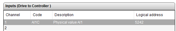

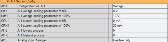

Well, before just changing the attributes of the MB_Client FB, shouldn't the VFD be configured to have its AIx assigned for sensor readings? Again, my model is ATV630U30N4. Also, wiring connections must definitely be taken into consideration, for instance, a regular PT100 without any additional circuitry would not simply work if having its two end terminals clapped in AI1 and COM at the analog input interface of the VFD, right?
As an update:
intended it is to read the Voltage from AI1. On the VFD side, the following parameters were set as Inputs:
and AI1 is configured as "Voltage":
On TIA side, the "Data_Receive".Voltage is set as INT, and this is the corresponding output:
The value "576" is stubborn and does not change with the change of voltage level at AI1. Keeping in mind that I can actually see the voltage level on AI1 via the VFD Webserver. But the AI1 assignment is non-modifiable:
Of course You need to assign what You want to read first, thought You will do the job ;).
AI1A will not be configured at the I/O-Assignment. Here You will see where it is assigned to. So it is Read-Only. It auto-assigns if You turn Referency over AI1 or thermal protection over AI1 etc.

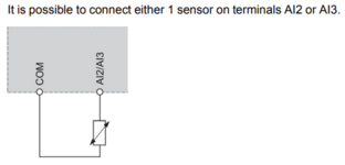

No, don't use external circuits or a power supply on this ports.
PT100 on AI2&AI3:
5mA current
Range 20-200°C
Tolerance: +-4°C within a temperature variation of 60°C
AI2&AI3-wiring:
How old is Your VFD? This picture is out of EAV64301.11 — 06/2022 while the 04/2020 has an option for up to 3 sensors in a row on ai2 or ai3 (with average monitored output).
I'm using this one for the latest drives: https://download.schneider-electric..._manual_EN_EAV64301_11.pdf&p_Doc_Ref=EAV64301

AI2&AI3-wiring:
Hello again,
My VFD is also from 2022 series (brand new). I did exactly the same wiring as within your attached image. As an alternative trial, I have set AI3T to PT100 and placed the physical value AI3C of the sensor on the Inputs list:
What else must have been done in order to have readings? Using MB_Mode 103, data addr 0 and len 1 I did not receive any significant values from the MB_dATA_PTR (Int).

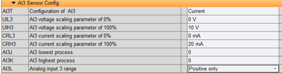

By taking into consideration this circuitry (PT100 is to be connected on AI3):
And MB_MODE = 103, MB_DATA_PTR = 0, MB_DATA_LEN = 1 and having set AI3C on Channel 1 of Inputs:
Could you please state what is left to be configured on the side of the VFD, in order to read temperature on MB_DATA_PTR?

Anything must be missing on Your drive, might You share the somove-project? I would like to transfer it over to the 950 and look what it does here.
Hello,
I have just notice this request. Attached it is the SoMove project including:
1) an ability to write to the VFD (LFR)
2) an ability to read the voltage input on AI2
3) a configuration for AI3 to support PT100, but still, on TIA I cannot see anything related to temperature
